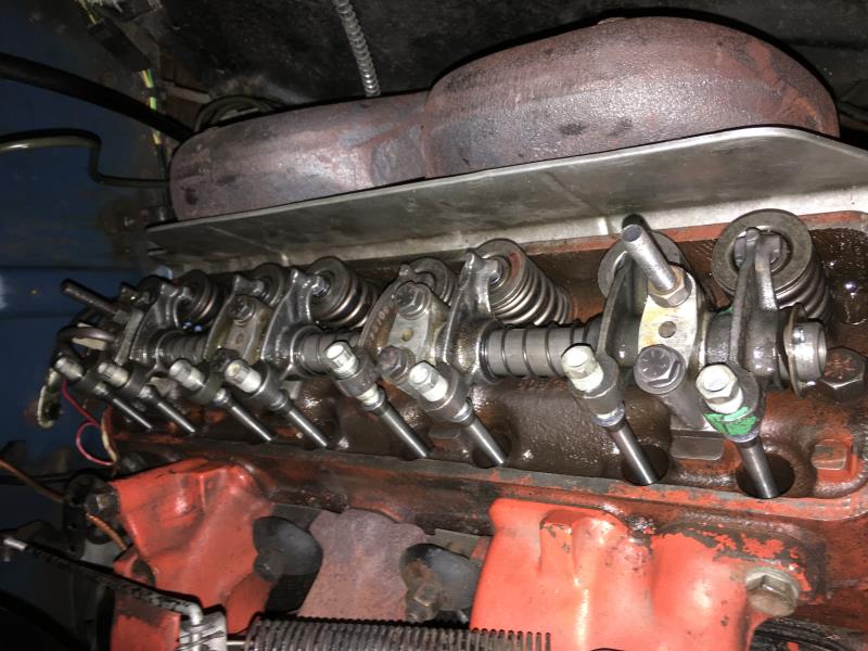

Gonna take one for the Team, installed all 16 of the Elgin pushrods today along with the new rocker arm assemblies. We'll see if they hold up. Is there a warranty on these things? If they break I want my money back.
Guess I better throw a couple OEM in the glove box just in case. Everything looks good. Replaced and shimmed 16 valve springs, cold lash &c, all that's left is reinstall plugs and fire it up and let it run in for a while. Did put a spot of Moly on all the rocker tips, rod cups and ends for good measure.

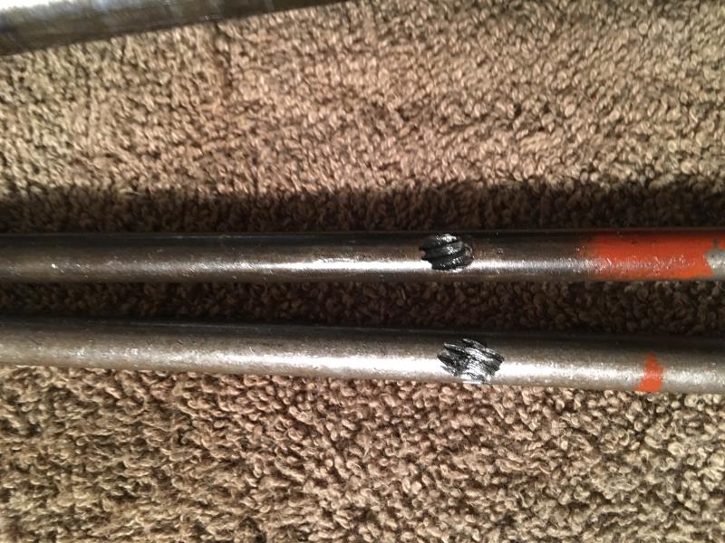

Looked at the old OE rods a little more carefully, not scientific tho chucked them in a drill and ran them on a rocker placed in a vise eyeballing them while spinning. Quit after checking about half of them - all bent or wobbly to some degree. Runout limit is only .005" or somesuch.
Two of them showed that at one time (not now) incorrect intake bolts had been installed. Great work by my engine "rebuilder". &@%#!! crooks.

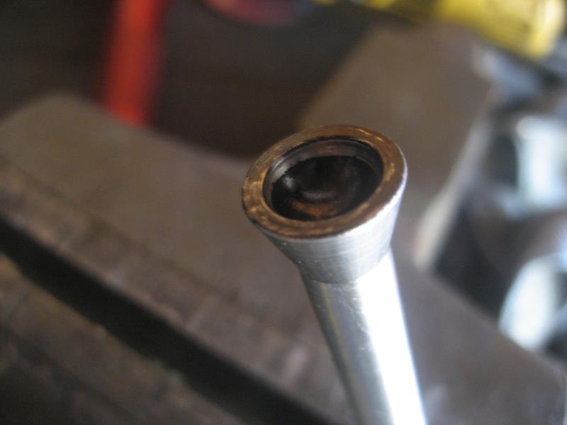

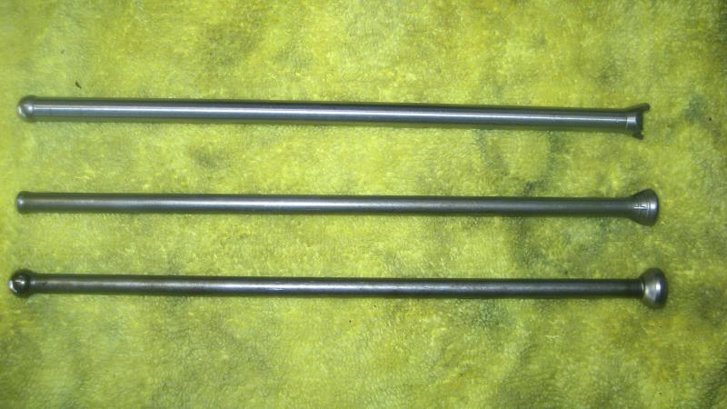

I finally got the camera to work LOL. Top is the one that broke Middle is the OEM set I found in the unmarked box Bottom set is unknown to me, I only remember taking them out of a Y years ago. Maybe some one will recognize them..
By 57RancheroJim - 8 Years Ago
This afternoon I colored the cup with a Sharpie and spun an adjuster in it. You can clearly see that the ball only hits on the top edge of the cup and doesn't come close to the bottom. Elgin claims their prints say the cup is .370 but I can tell you the parts aren't..

What's interesting to me is that it appears that the PR-71S have the correct size cup, according to my not so scientific tests. They were manufactured this year as well. The only difference between the 71S and 73S pushrod (one would think) is supposed to be the length.

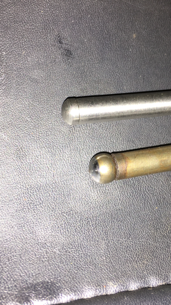

Noticed from the pics the #73 pushrods have the large ball on the lifter end, similar to stock. #71 don't have this.
Tedster (11/17/2017)
Noticed from the pics the #73 pushrods have the large ball on the lifter end, similar to stock. #71 don't have this. Ted, I'm a little confused, I don't see anything with a #71 or 73. All my OEM pushrods have the small ball. Are you saying yours has the larger ball? Can you post a picture of yours?
By Tedster - 8 Years Ago
No, the PR-71S pushrods don't have a ball end, it's basically the same diameter as the rod itself, will try to post a pic later, need to double check lash anyway. That's what's kind of puzzling. PR-71S is listed for 54-56 Y Block V8 on eBay, those are what I purchased, as my thinking went Mummert's site lists "long" pushrods as correct except for '57 or somesuch. PR-73S are listed by Elgin as 56-64. Their pictures on the auction site are just stock pics so aren't really helpful. If I can find my sharpy we'll do the cup test too, but they sure seemed to fit fine, if a little low. I'd like to see a deeper cup just because that's what I'm used to.

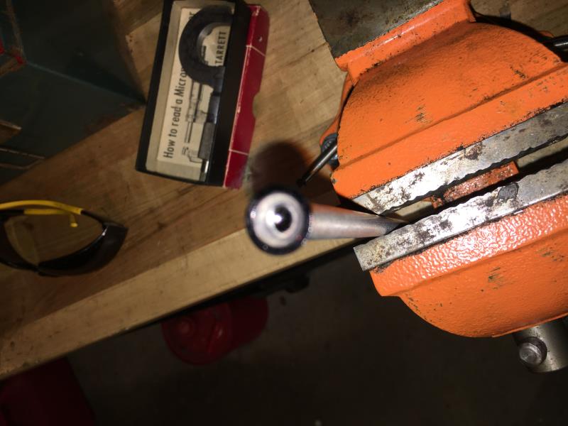

Here is PR-71S showing lifter end. The sharpie test seems to show a decent contact patch, the OEM rocker screw has a flat spot at the bottom, so it won't be 100%

The first pic is a screen shot closeup and is distorted for some reason on upload, not sure why that happens. They are round.
