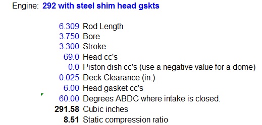

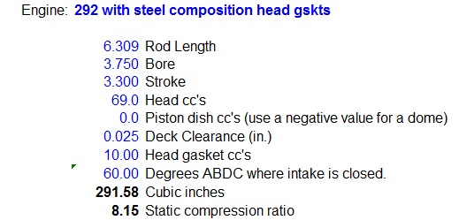

Florida_Phil (7/23/2017) Thanks for the great head chart. The heads off my 1957 272 have the casting numbers ECZ-G cast into them. From your chart I see they are the same as the 312 heads. If I bolt them onto my stock 1955 292, will I have 8.5 compression ratio? Should I mill the heads to raise the CR? If I do will I need to mill the intake? I won't know what the engine in my TBird actually is until I take it apart. It looks original, but it's too clean to be untouched after all these years. Assuming the 292 short block is dead stock (no boring, no milling, steel shim head gaskets, etc), then 8.5:1 is attainable assuming the ECZ-G heads are indeed 69 cc’s. If using composition head gaskets, then the static compression ratio is going to drop some. Here are a couple of quick work ups showing the differences in the static compression ratio when changing the head gaskets.
You will need to check your ‘G’ heads to see if they are posted or unposted. The Ford shop manual recommends only milling unposted heads a maximum of 0.010” but general consensus is that you can get away with as much as 0.025” of mill assuming you’re not going to be running pop up pistons somewhere down the road. Posted heads can be milled much more heavily without experiencing the same problems with head gasket seal.
