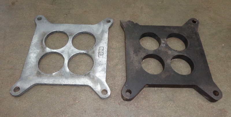

The 1957 312 4V engines came with either a ¼” or ½” thick 4 hole carb spacer and those could be either phenolic or aluminum. All the 312 phenolic spacers I have are ½” thick but the aluminum ones come in either thickness.  Car versus Thunderbird maybe? Those spacers were not angled and simply raised the carburetor an even amount.
Here’s a picture of each.
http://forums.y-blocksforever.com/uploads/images/9a8d0559-4ab1-466e-bbaf-68b3.jpg

The '57 Ford 312 carb to intake spacers I've seen were 1/2 inch thick phenolic plastic, dark brown in color. These have had no identifying letters or numbers on them.  Also, they had no taper that I observed nor markings to indiate Front.
