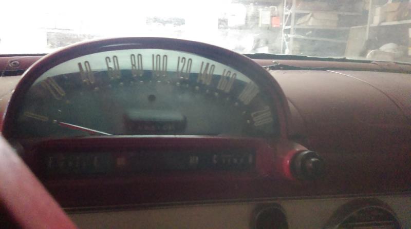

Prof, From brodie knob (not sure of proper word here) to the 200MPH speedo I think you have a real gem to start with. Looks very solid.  I am looking forward to seeing your progress on this! Cheers - Bob
By Lord Gaga - 9 Years Ago
Cool car, a glass top too! Maybe along with the KM/H speedo, those rods are Fords early "Export Braces"??
By Ted - 9 Years Ago
This particular Glasstop Crown Victoria being a standard shift is unusual by itself but that kilometer reading speedometer makes this car very unique.  There has to be a good back story on this one.http://forums.y-blocksforever.com/uploads/images/3b12b8eb-3d5f-434d-abe6-7740.jpg
