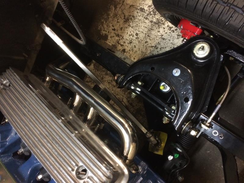

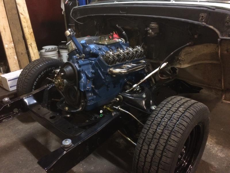

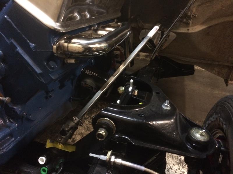

Well I bought these headers to try out. I think you're all right; they probably won't flow much better than regular log manifolds. BUT, they do fit the trucks really well. I threw em on my build and took a few pics. I have a couple mods going on regarding the steering column but the tube headers would still clear a totally stock truck FYI Smile

By charliemccraney - 11 Years Ago
Did you try them on a totally stock truck?  It looks like the outlet is right next to the steering box and clutch linkage, judjgng by the holes in the frame for mounting the clutch z bar pivot.
I would not declare that until they have actually been installed on a totally stock truck.
By matt2491 - 11 Years Ago
They will fit. I had the stock column and clutch linkage hooked up before taking them out...
